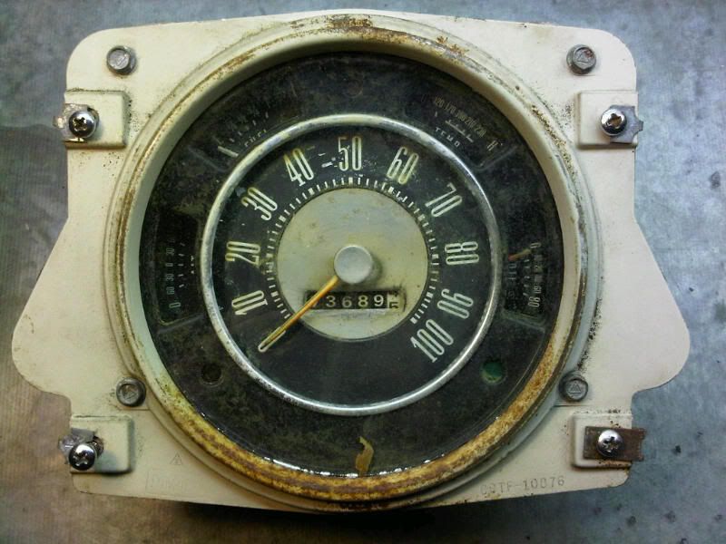

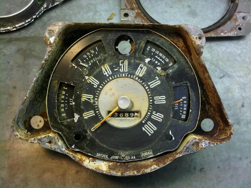

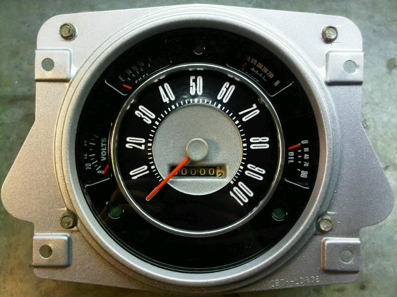

Ok, here are the before and after pictures of Rick E's gauge cluster. As you can see this cluster had sustained significant water damage over the years. I was able to salvage two of the three auxiliary gauges and the fourth (amp gauge) was replace with a voltmeter. The gauge faces were so corroded that I had to add black overlays to correct the damage. The corrosion had eaten right through the middle of the fuel gauge needle so that was replaced also the green turn signal lens was missing so i added a new one of those.
This gauge was a lot of fun to refurbish. Obviously gauges in this condition present the biggest challenges and also end up being the most gratifying to repair.
Thanks for the challenge Rick!!
[IMG][/IMG]
[IMG][/IMG]
[IMG][/IMG]
Looks great! found out the whole rig went swimming in salt water going to be lots of fun restomodding this one
