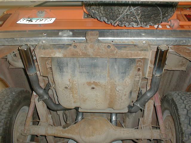

Don't know if this will help or not:
[/IMG]
RangerVee, do you get any exhaust roll-back into the cab when you run with the top off? I've heard many different theories about rear vs. side exit.
Sorry. Haven't done that yet. Those pics were taken last Friday.
