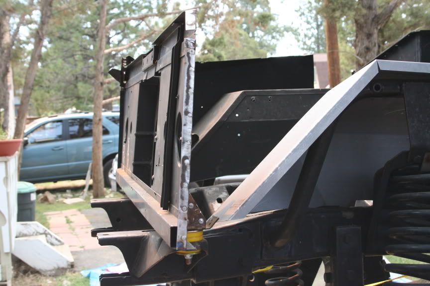

Like I said before, I've had good results with a Dewalt 3/8" Dual Point drill bit.
Most hardware stores sell them and it doesn't cost much.
With the Black and Decker brand its called Bullet Point. Just center punch the spot weld and drill, It doesn't have to go through, depth only needs to be enough to where you can split the panel apart.
