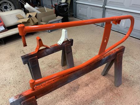

Hopefully getting a roll bar installed today. We were going to do it last week but the Bronco started running very rough. It took me a few days to fix the problem. I first thought it was electrical and chased some electrical issues. Coil, bad wiring, timing, points, etc. Turned out to be the carb - a thorough cleaning and rebuild got it running like a top again. Tweaking the electrical issues helped some as well! I'm guessing it was one residual bad gas that gummed up the carb. I really thought I had flushed the fuel system pretty well . . . but I apparently did not.
A member here has bent up all the tube to look like a Stroppe roll bar and we are going to fit it up this evening.
