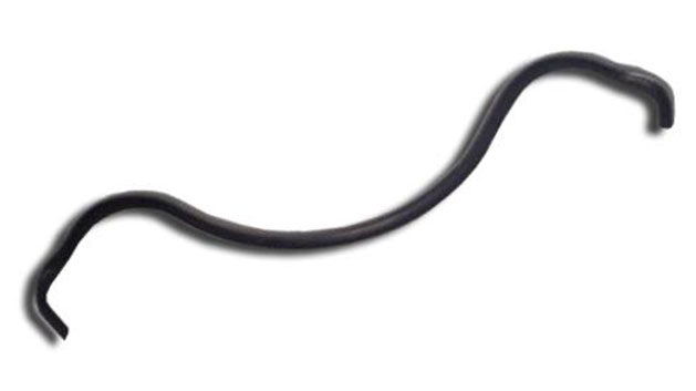

When I took the boot off and released the spring, the fork feels loose and sloppy in all directions. I see the crease in the fork where it pivots, but it just doesn’t feel right to me. Is the fork really that loose or am I missing a piece that holds it in place? I see some holes just above the pivot crease but they are empty.

Looks like you are missing the clutch fork bail spring
A $7 fix? Holy cow…..that would be a first. LOL. I’m assuming that keeps the tension on it. Googling pics now to see

PS Early Broncos used 2 different type of clutch forks and their respective attachment pivot clips, you have the bail wire spring type.

Assuming I can put the spring in without dropping anything, correct?
If it is gone, it probably fell into the bell housing. Anything I should be worried about?

All adjusted and clutch engages at the right spot now, but that anti-rattle spring is missing……
Anybody have advice for this??

I read on some mustang forums that people sometimes leave out the spring since it is a pain to get installed.
Seems like it is optional.

The spring goes inboard of the pivot point on the bell housing and does provide a little bit of stabilization. I have taken many apart, half the time they are missing. It would be really hard to put in without unbolting the trans from the engine. If you have the proper adjustment on your the push rod and the proper return spring, it should be pretty stable with out.

Thanks for the info BG. After the pushrod and pedal adjustments it really feels good and operates/engages smoothly. Sounds like it will be fine….we’ll see.

I‘m in the Process of installing a new Blueprint 306, so I just installed the fork with new throw out bearings and new clutch. Believe me it was a major PITA to slide the fork spring clip into the tab located on the bellhousing, I mean it took over an hour to install. But once it is in place correctly the fork became rock solid with no slop.
