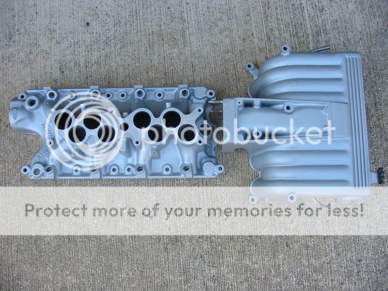

And here are a few items I've bought and am waiting to pick up:
1987 Mustang 5.0 block bored 0.30 over, Magnafluxed, hot tanked, honed, decked, line bored, new freeze plugs and new cam bearings. Painted Ford blue with white epoxy in lifter valleys to improve oil drainback
GT40 intake, hot tanked and coated with high temp paint, from Ford Explorer
I may also buy some GT40 Cobra heads (magnafluxed, tanked, valve job, resurfaced, new valve stem seals and new freeze plugs, from an Explorer during that brief period where Ford put the cobra heads in them) from the same source. I know they're not ideal or anything special compared to AFR 185s or TWs or whatever, but I think they'd probably be fine for my application.
