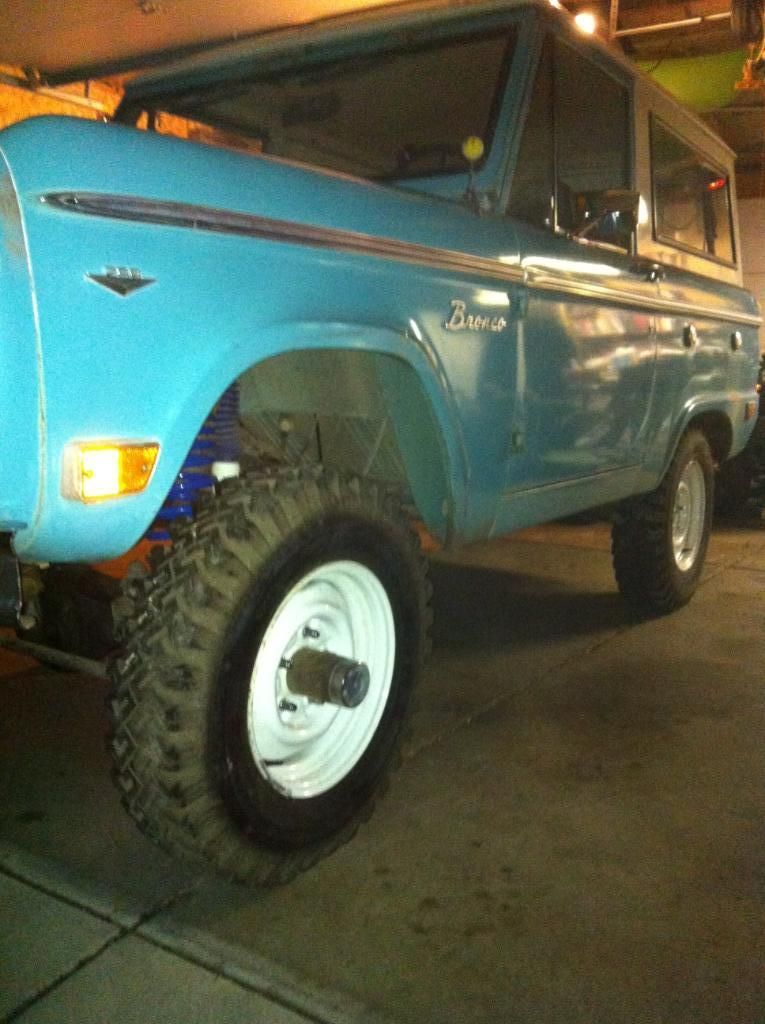

I'm running Interco 9.5 X 16 X 32's on my LUBR, with a 2.5" suspension and 1" body lift. Until I moved the axle back 3/4" I had some rubbing on the front edge of the rear fenders when the suspension was fully twisted up. Not sure if the extra inch of lift will get you clearance for 34" tires. Someone has actually done it, I'm sure. Maybe they will chime in.

Did you use those Extreme Offroad "zero leaf" blocks to move the rear axle?
