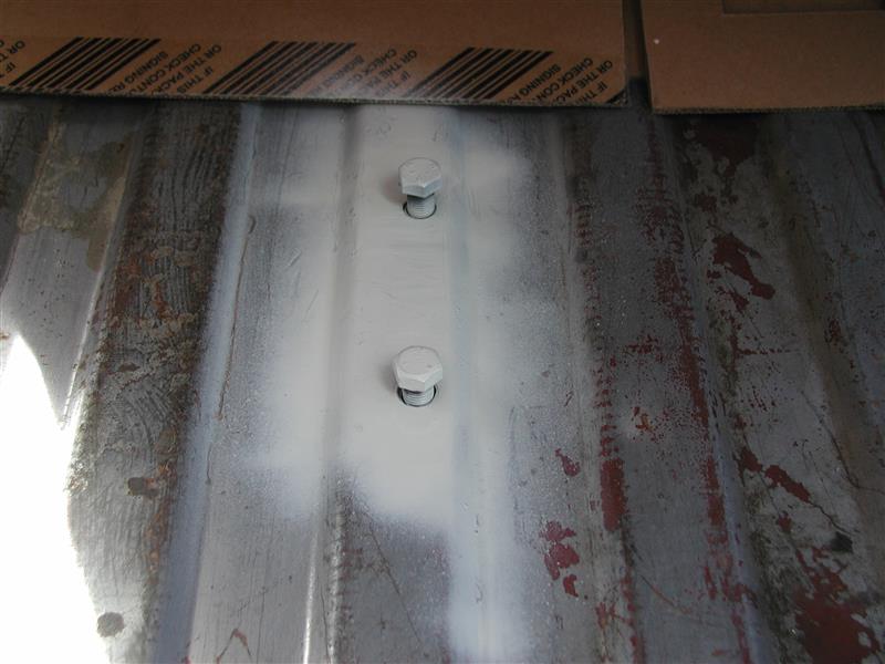

Of course one of the holes landed on top of a body cross-member. I made some captive nut plates. Had to open the floor up to install the one above the cross-member.

Did you take any "step by step" pics of the captive nut plates? Just curious as to how you went about it. Simple enough concept though.

Some pics for the curious.

On the captive nut plates, they are just 1/8 steel with a nut tacked on. Then I driledl additional holes on either side of the nut and plug welded them to the floor and ground flat. Where I opened the floor, I just cut the three sides, installed the plate and closed her up with a series of short welds.

Nice , I would have never thought of drilling a hole for the weld. Great idea , use the bolt to "clamp" the piece in place and weld/fill the hole. I love it.
