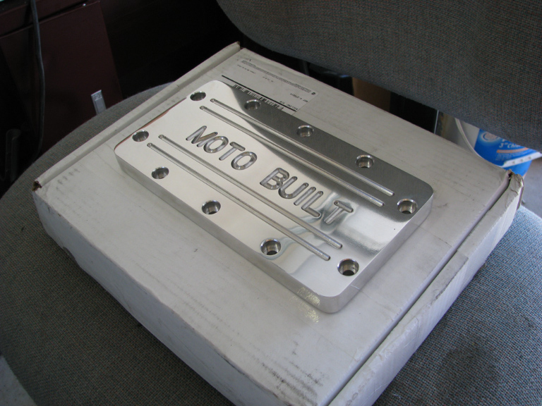

By the time I got to Steve's house he had completely disassembled my transfer case and cleaned everything. In preparation I had taken my inspection cover to a friend and asked if we could so something cool in aluminum. He taught me how to use a mill and this was the result!!!!
Shelby (son) and I had spent Friday night sanding and polishing the cover. Now at Steve's house we inventoried all the parts. He noted the shift fork was loose we he took them apart. Could be the reason my truck would pop out of hi 2wd.

Nice work! The custom cover looks sweet. Thanks for posting all the pics.
