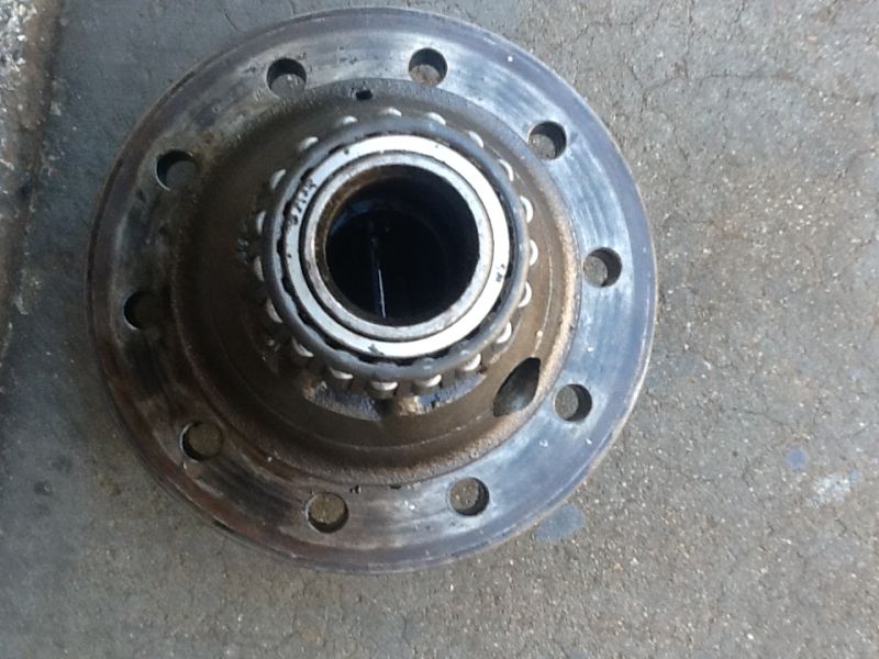

Yea, that's not the one I got, mine only has a blind roll pin no screws , i think thats where my problem lies, I'm gonna take pics on lunch here in 20 and post... Stand by

Ok, so here are the pics of my diff.
I'm now 99.99% sure it's a posi and not a tracloc. Someone must have installed at a later time but judging by the smell of gear oil prolly 30 ish years ago.
Oh well I'm gonna clean it up and run it, instead of spending 500 on a trutrac.
What to the experts of cb.com think bout it?

Yup, that's what I figured.
So, I guess the mystery is solved then.Factory it had a trac-loc and someone down the line (maybe in the 70's ) changed the diff to a posi trac.
Or... Did I get special rear end as an option? Idk. But I hope changing to th 3:50 s won't turn my 289 into a turd bucket! Did I already say that , idk but I really liked the 4:11 s , even with my new c4 pushing 33" mudders and on freeway i didn't even notice and don't really speed in my 40 year old bucket.

That is a picture of a limited slip unit. The earlier models do not have screws to hold the two halves together. My 68 had a factory limited slip unit and it had no screws, the earlier ones were called equa-lok or something and are slightly different. The only way to tell is to pull it apart and count the number of 'tabs' on the clutches. If there are 4 tabs it is the later trac-lok (which has the screws) if it has 5 tabs then it is the earlier equa-lok (no screws). I'm not sure what the strength difference is but I do know the clutches in the equa-lok are much larger than the trac-lok clutches.
The roll pins I think you are referring to hold the spider gear shaft in. Once you get the 2 halves apart, you have access to the rear of these pins to drive them out. Unless you have gear damage though, there is no reason to remove these pins to replace the clutches.
